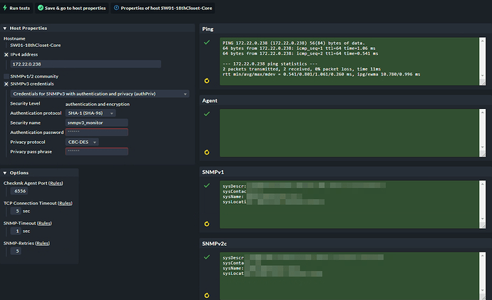

My problems are, after entering a new host (with SNMP credentials for SNMPv3 with auth and authPriv), I clicked on “Save & go to connection tests”, I see the following:
  1. it doesn’t remember “Auth password” and “Privacy pass phrase”. as you can see now, I have entered them again, and “Run tests”, SNMPv3 shows just fine: https://i.imgur.com/jOC2ZlF.png
  2. as you can see from the first screenshot, “SNMPv1/2 community” was not checked, and yet, it queried the device using the methods.

The connection tests always test all SNMP versions, regardless of the host configuration.
Just save the configuration and go to the service configuration to see what check items are found on this device.
You should click Save & Go to Service configuration instead
