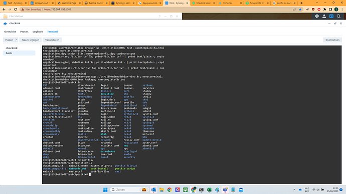

i can use the terminal of check mk inside the dockercontainer but seems i cant find the smtp settings been looking under /etc but so far no luck

Based on your screenshot postfix is already installed, you need to configure it accordingly.
