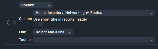

When you use mk_inventory.vbs on Windows, and probably Linux inventory might have it as well, it gives Routes as extra level under Networking in the HW/SW inventory.
Which can be made visible in a view with following column:
But it is a table of all the routes configured per interface, I only showed the first row, so it will make your host rows a multitude of the route rows there are. Which might not give the overview you seek.
