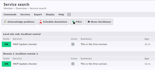

I reproduced it with 2.3.0p42.cee in two docker containers (central and one remote site) and the attached MKPs. The distributed environment is not even neccessary. The problem also occurs with just one site.
Install and activate MKP-1.0.0 and make a service discovery. It will show this service on all hosts that supply a section <<<omd_apache>>> (content doesn’t matter):

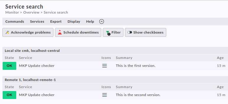

Then install and activate MKP-2.0.0. No matter what I do in the GUI (activate, discovery, wait, …). The output is still the same:
When I finally do cmk -R on the remote site only, I get this:
So apparently the cmk -R is crucial when updating MKPs via GUI.

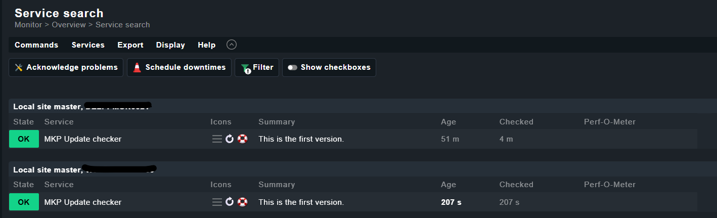

Installing mkp-update-checker 1.0.1 shows me the service as expected on two hosts:
After installing and enabling mkp-update-checker 2.0.1 the version 1.0.1 becomes inactive and 2.0.1 active in the GUI and on CLI:
mkp-update-checker 2.0.1 MKP Update checker Dirk 2.3.0p34 None 1 Enabled (active on this site)
mkp-update-checker 1.0.1 MKP Update checker Dirk 2.3.0p34 None 1 Enabled (inactive on this site)

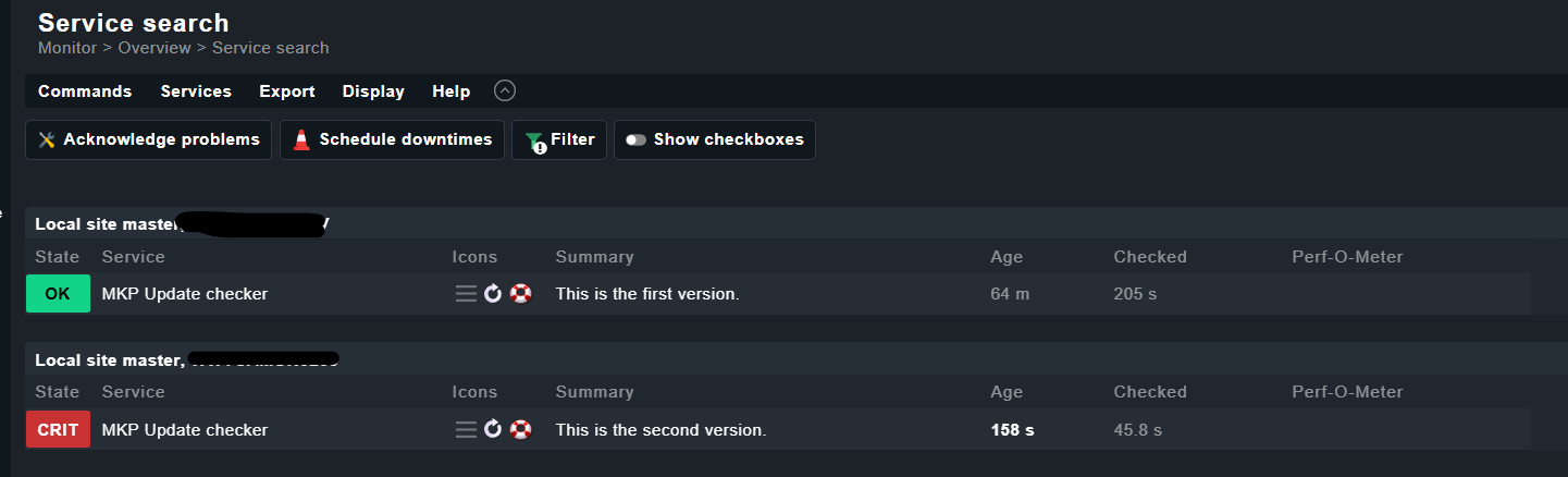

After Activating changes and re-scheduling the check in the GUI the service Summary doesn’t change as described above.
In addition to the Summary I also changed the state to CRIT. Also this doesn’t change the state in the GUI.

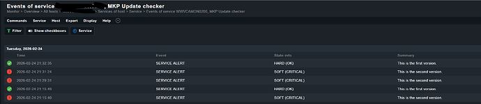

But after re-scheduling the check in the GUI it shows again the wrong result!
In the event history the different results are listed:
