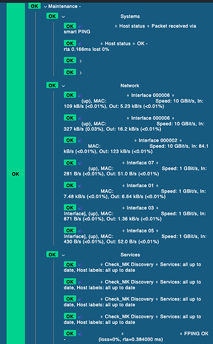

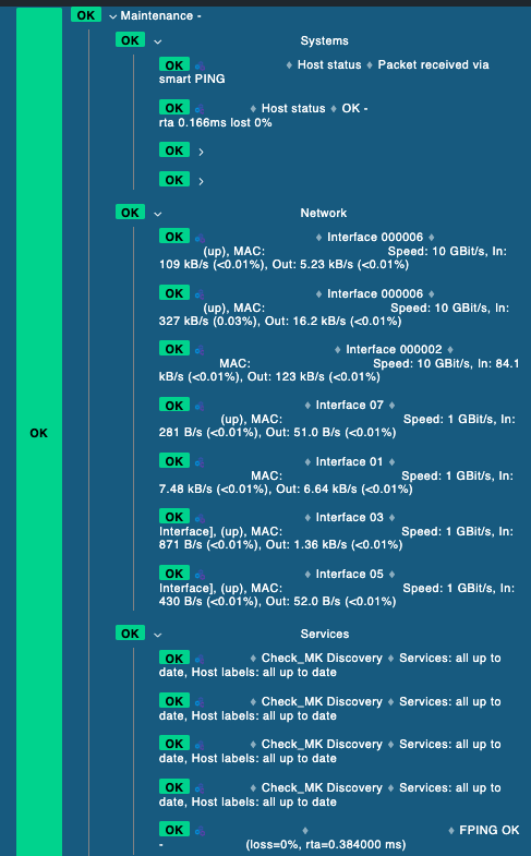

I can confirm that: The BI is now completely broken. That’s quite an achievement — managing to go an entire year without releasing a fix for a problem, only to end up making it stop working altogether.
I tested it on a CheckMK instance without my BI fix just to be sure — turns out it wasn’t me who broke it, it was the CheckMK team.
I rolled back to p38 and will wait until it’s fixed — or I’ll fix it myself.
