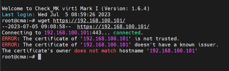

is there a firewall between your checkmk host and the sms eagle device?
i.e. can you reach the URL via wget from the CLI?

It seems I still have errors with the SSL. I’m doing this on my test lab, will this be possible with self signed certificate?
Not sure if the issue Im having is related with this but its very possible.
But its weird cause I’ve added the SSL certificate to the trusted certificates
@gstolz I’m wondering if this will work with Self Signed or not. So far I’m not able to make it work

I doubt it’s an issue with the self-signed cert, we’ve got a few smseagle at customers, I don’t think any of them replaced the built-in self signed cert.
