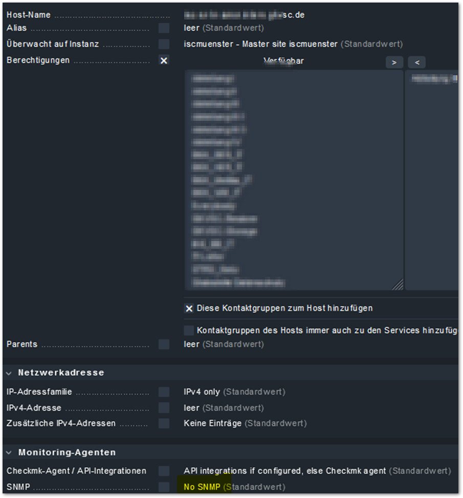

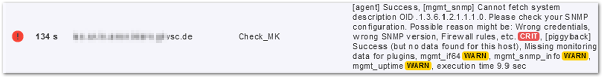

Yes - in your error message you see “mgmt_…”. This device has a management interface configured with SNMP.
Please remove this configuration and then the error should be gone.
I would advice to create the management interface as a separate host object inside CheckMK for monitoring.
Damn :wink:
That’s right!

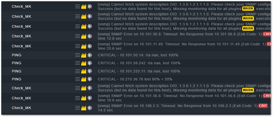

Here another sample for the error:
Is SNMP monitoring working on these devices?
The error only means that there is an SNMP timeout but it is not visible why.
Yes, that’s the crazy thing: all SNMP-based devices work perfectly. The messages are simply wrong.
Once or twice a day this message appears, as if Checkmk itself had a problem.
There can only be a problem on the CheckMK server if there are not enough resources available to do all the checks.
I think the reason is actually a lack of resources. A second instance was also running on the hardware (test for Openshift monitoring).
I have uninstalled this (omd rm XXXX) and am now observing the phenomenon.
