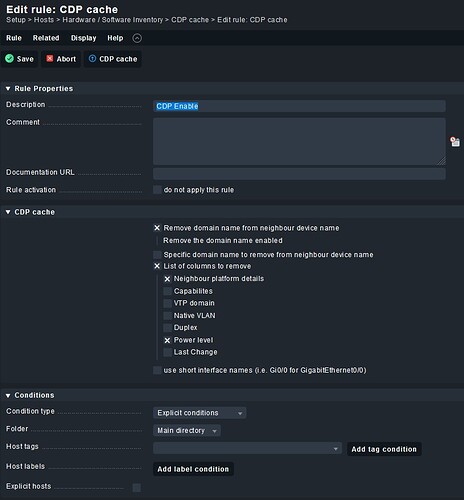

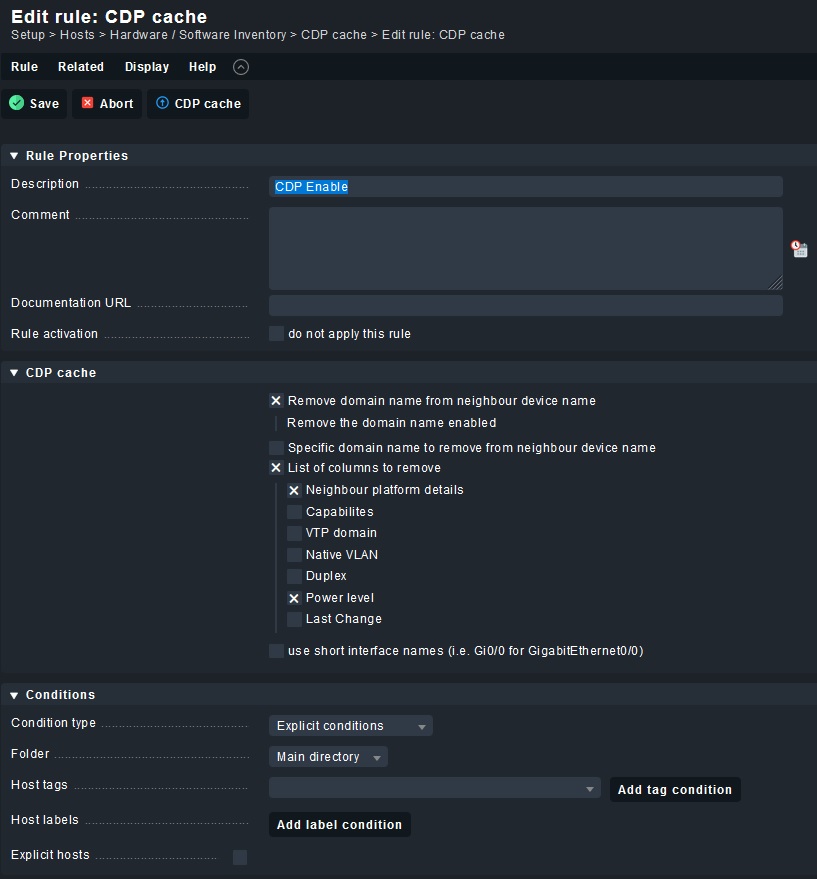

I’m losing SNMP connection on this switch when I created CDP rule.

So if you remove/disable the cdp rule, then SNMP for this switch is working fine again?
Sometimes the SNMP communication comes back after the rule is removed.
this is a litle bit strange, as this rule has nothing to do with the way snmp works. Its a rule for one of my inventory plugins and will only change the content of the inventory…
