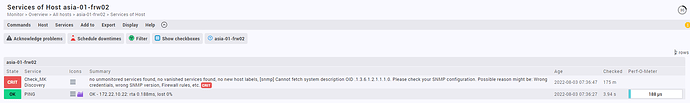

Snmp not wokring on my Fortigate firewall
**CMK version: 2.0.0p19
OS version:
**Error message: no unmonitored services found, no vanished services found, no new host labels, [snmp] Cannot fetch system description OID .1.3.6.1.2.1.1.1.0. Please check your SNMP configuration. Possible reason might be: Wrong credentials, wrong SNMP version, Firewall rules, etc
I`ve tried to do this list but still wont work
-Snmp version
-firewall rules
-snmp community credentials
-snmp is configured on device
-enable snmp on the mgmt interface
-add CheckMK IP to trusted host on the mgmt port
-snmp queries and traps are enabled

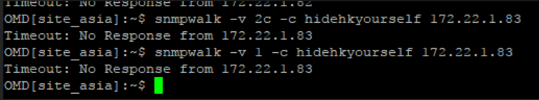

Snmpwalk from the cmk server works?
Ralf

Hi rprengel for the snmpwalk for the cmk server it did not work
Hi anders snmpwalk is not working per checking on the chkmk server
Hallo,
this means your cmk server cant reach the fortigate via snmp.
Ralf
