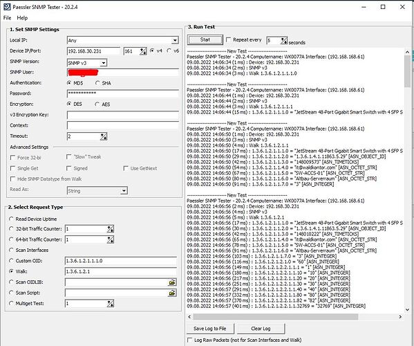

The other I get SNMP timeout error. If I test this with a SNMP tool, it is working with v1 and v3.

Here the result from the tool…

maybe you did not read my last paragraph. I am able to reach out through SNMP on the Check_mk Enterprise edition I have installed for testing purposes. As I gone deeper into the root cause, the main difference between our RAW instance and the Enterprise is that RAW is installed in a Docker container.
Installed like described in this article https://geekflare.com/checkmk-monitoring/
I checked SNMPGET from the Docker container and this is not working, same check from the Ubuntu instance where the Docker container runs, works perfectly. The weird fact is that SNMP (all versions) is working from OMD/check_mk to other devices like firewall, temperature sensors, printers etc. Even more weird is the fact that switch 192.168.30.233 is being read out via SNMP but all other access switches are not.
