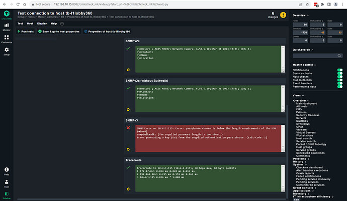

SNMPv3 Error: passphrase chosen is below the length requirements of the USM (min=8)
CMK version:
Checkmk Raw Edition 2.2.0p5
OS version:
Checkmk for Docker
SNMP Error on 10.4.1.115: Error: passphrase chosen is below the length requirements of the USM (min=8).
snmpbulkwalk: (The supplied password length is too short.)
Error generating a key (Ku) from the supplied authentication pass phrase. (Exit-Code: 1)
Other
Passphrase is correct as I’m able to snmpwalk using MIB Browser. Error is occurring with all Axis Communications security cameras, but the specific example provided above is a M3027-PVE running firmware version 6.50.5.10.

Thanks for the reply! I should have mentioned we are using Authentication but No Privacy (authNoPriv) with a ten digit alphanumeric password, which is why this error is so frustrating.
Without seeing the real snmpwalk command it is hard to say whats wrong here.
As you are using the Raw edition it is very easy to see what the system does.
With cmk --debug -vvI hostname you get the snmpget command for your system to fetch the system description OID.
If you can show us booth, this one and your manual working snmpwalk, i hope that a difference is visible between booth.
Attached are results of both snmp-walk commands. It appears the Checkmk results are not as complete.
cmk snmpwalk.txt (14.6 KB)
MibBrowser SNMPWalk.txt (41.0 KB)
Booth walks have the same data. The MibBrowser walk also includes the OIDs .1.3.6.1.6… These are not relevant as it is internal SNMPv2 data. Normally not fetched by CMK.
But the snmpwalks are not the problem i think. You said that CMK will not use your SNMPv3 config.
That’s why i wanted to see the snmpwalk command not the output :slight_smile:
Please compare your manual walk command and the snmpget command you see after cmk --debug -vvI hostname
