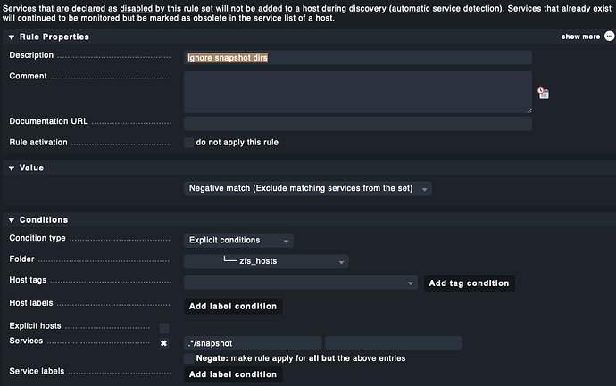

I tried to exclude the snapshot folders with a rule in the “disabled services” area.
One rule would be 'Service name begins with .*\.zfs.’ which doesn’t work.
I also tried with 'Service name begins with \/.*\/.*\/.*\/.*\/\.zfs\/snapshot.*’ which should ignore mounts like ‘/mnt/ritankc/projd/p_hpsn/.zfs/snapshot/’ but it doesn’t.

Filesystem /mnt/ritankc/projd/p_ntil/.zfs/snapshot/risnap_weekly-2021-09-22-0350
And I tried ‘Service name begins with .*/\.zfs/snapshot.*'
Nothing is excluded, I did “Actions: remove all and find new”

That’s weird, it’s always picking up those services again.
Can you show the complete rule definition?
I’ve now even shortened it.
If you change the “Negative match” to “Positive match” then it works.
Your rule exclude the snapshot from the disabled service rule :wink:
Oh well, there we go :smiley:
Thanks very much Andreas
