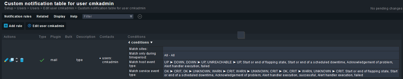

you can see my rule here
and email with suubject OK → WARN is received eg Check_MK: srv/Memory OK → WARN

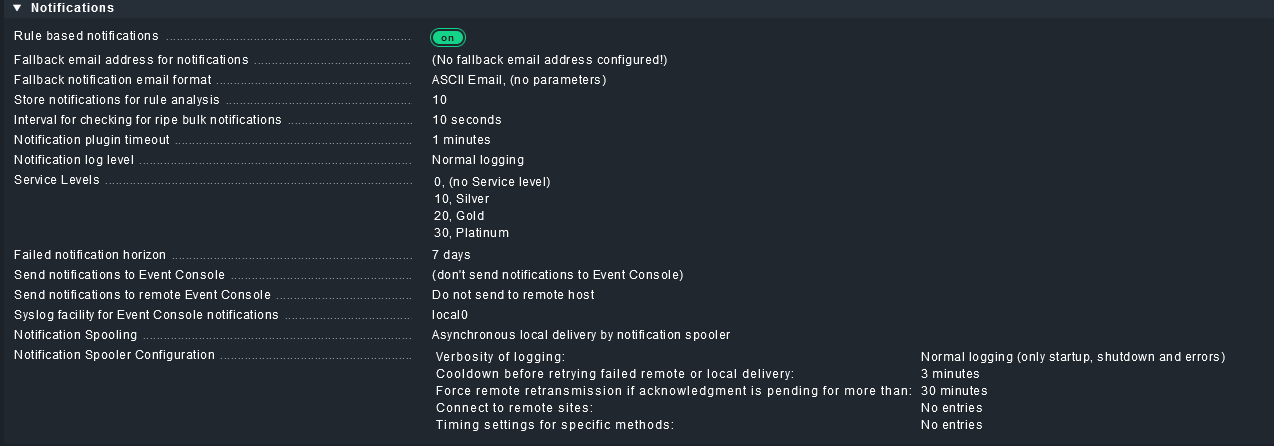

have you checked if your user has the “receive fallback notifications” setting activated or if your address is configured in the global settings as “fallback email address” ?
no, it’s not configured

I have used it on 1.2X version. My configuration:
cmkadmin on Setup ->Users has configured email address
and these notification rules are created on “Custom notification table for this user”
