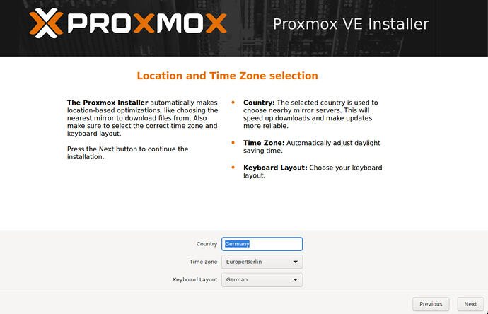

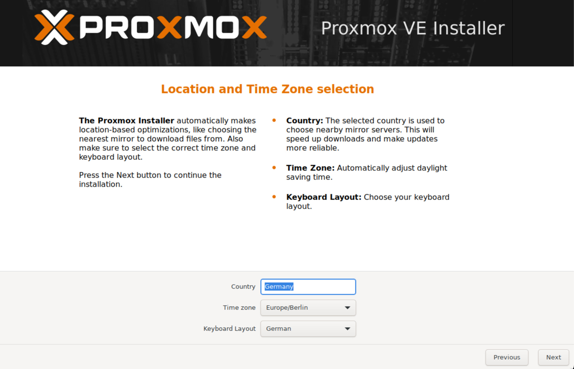

I asked my colleagues how the proxmox installation was done. They use the ISO file that can be downloaded from proxmox and followed the GUI step by step. Three of five servers had no time zone.
That’s quite interesting, it must have gotten lost at some point, because setting it is part of the installation process:

I just did an installation from the Proxmox VE 9.1 ISO and found the following:
  • i did not touch the timezone selection during installation. It showed Europe/Berlin
  • After the installation the timezone was not set for the node in Proxmox UI
