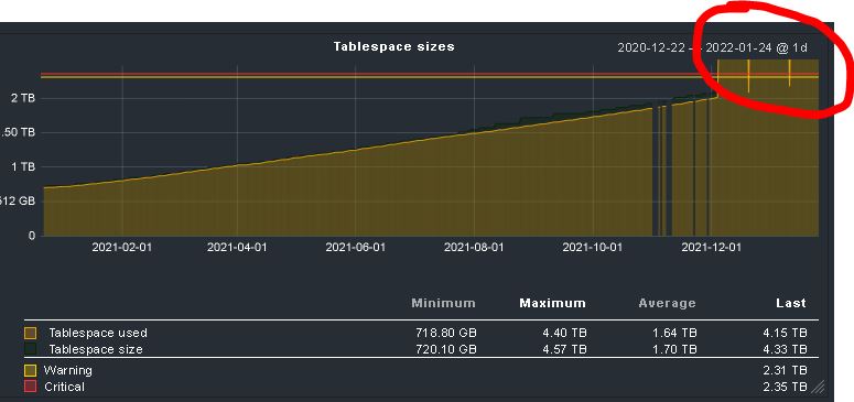

Since Dec-05 some strange spikes has been visible:
The TS occupies about 2,3TB, the drive is as small as 3TB, but the spikes even reach more than 4,3TB

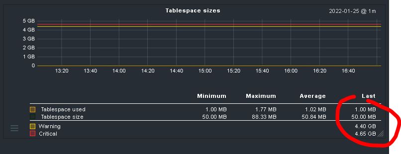

Only one TS is affected, but others on same instance have weird limits (but not any spikes) :

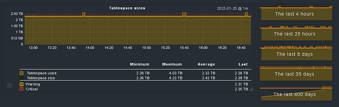

It is happening from time to time:
The weird TBS could be UNDO or TEMP TBS which are most of the time empty and if you have set the limits to absolut this may have no sence at the graph level.
I see you have outoextend on at least one data file. I suggest there are index rebuilds ongoing and for the rebuild process indexes need the space twice until the process is finished. this could lead in such spikes. A bit curious i am about the TBS size, which shouldn’t shrink after such a process.
I am quite confident that this issue is not related to check**mk* but rather some suspicious processes at the DB itself.

Yes, while index rebuild more space might be in use - but not at all more than the size of the drive: 3 TB - that’s imho complete impossible.
and there isn’t any magical shrinking. All these datafiles have a fix size (which is the maximum possibly size) - the autoextend ON is an heritage.
Is it possible to get the agent section oracle_tablespace from the time point if these spikes in the graphs happen?
I meant the other instance you posted the picture about. But after thinking through this might be the case because you have set an upper threshold which isn’t total size related.
