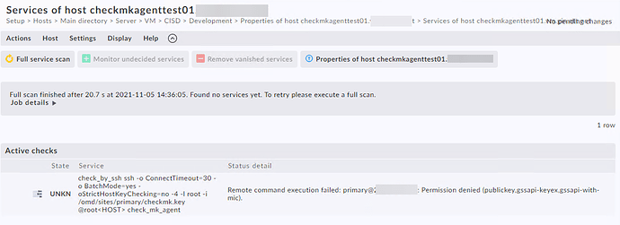

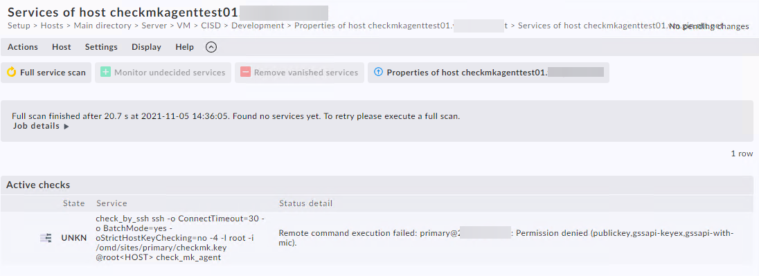

There is currently only one rule for ssh tunneling (unless one is built in and I didn’t see it). I added this one myself and then associated it with this singular host. Currently our deployment is greenfield.

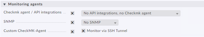

Here is the monitoring agents section of the host.
Wait a second. You want to call the agent through SSH, right?
What I can see in your screenshot is an active check for SSH connection.
You need to use the rule set Host check command.
And also the line has a typing error.
In your screenshot → @root<HOST>
Should be → root@<HOST>
I would also remove the “-l root”
But as @robin.gierse said do this for the special agent call and not the SSH active check.

And got it working.
The key to get it to show up as the agent was to change the agent/api integration option here (as well and make sure the ssh tunnel option I previously listed was still set.)
