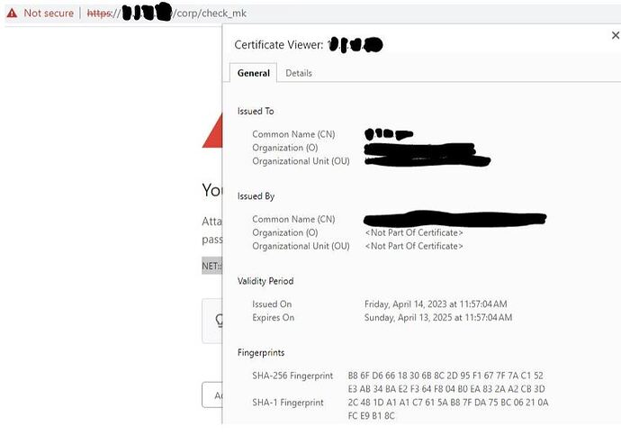

I issued an SSL certificate with and FQN, hostname and IP in the Subject Alternative Name extension. It’s working okay if I either use the FQDN or the hostname in the browser to connect to the console, but I get this meesage:
Your connection is not private
Attackers might be trying to steal your information from NN.NN.NN.NN (for example, passwords, messages, or credit cards). Learn more
NET::ERR_CERT_COMMON_NAME_INVALID
So, the certificate doesn’t seem to be working if I use the IP to connect to the console, it only works if I use the FQDN or hostname.

This server could not prove that it is N.N.N.N ; its security certificate is from FQDN_HERE . This may be caused by a misconfiguration or an attacker intercepting your connection.
Proceed to N.N.N.N (unsafe)

I had included the IP, FQDN and hostname in the cert’s SAN all along. But the error message clearly states invalid CN. I will put in the IP as CN value in the CSR, I guess this will fix the error.
BTW, no errors when I put either the FQDN or the hostname in the browser to reach to Check_MK console, only when I use the IP. I was confused I got an error because I had the IP as DNS entry in the SAN already.

I added the IP in the Common Name field and also in the SAN and I still get “Your connection is not private”
I’m starting to think Check_MK doesn’t allow for IPs in the certificate CN or SAN.

Users can still reach the console using the IP, the thing is the certificate is not valid so I get “Your connection is not private” Warning message. So a secure connection can’t be established by simply using the IP instead of the FQDN in the browser.

For what it’s worth, we finally managed to protect access to the console when using the IP in the URL by adding an IP-Address additional entry type as part of the SAN rather than a DNS-Name entry type.
