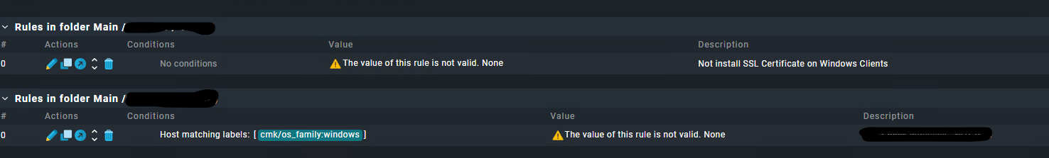

but the cmk-update-config resulted in an error.
That 2 rules are for disabling the plugin, “Do not deploy the SSL certificates plugin”.
So SSL Certificate still crash with same report after the cmk-update-config -v
ERROR: Failed to transform rule: (Ruleset: agent_config:sslcertificates, Folder: server/vdi, Rule: 0, Value: None: None
ERROR: Failed to transform rule: (Ruleset: agent_config:sslcertificates, Folder: server/rds, Rule: 0, Value: None: None
 + "Rulesets" failed

Hi
The sslcertificate do no longer accept my old rule that stops the plugin for deploying to some client
That where the problem when upgrading.
So now I dont know how to block the plugin from deploying
I have just upgraded to sslcertificates 9.0.3, but still missing that option
@r.sander I fixed the do not deploy by creating a regex exclude of host.
But you might note in the 9.0 release note, that you have removed the none option.
Or even better add it again :slight_smile:
Because the rule cannot be transformed and need to be removed before upgrade.
