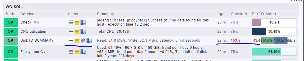

following the upgrading of check_mk agent from 1.6 to 2.2 on Windows server.
As seen in the screen capture, we frequently receive the Stale notifications below for the DISK IO Summary.
I merely wish to understand what may be the issue.
with 1.6 check_mk agent we never face this issue.

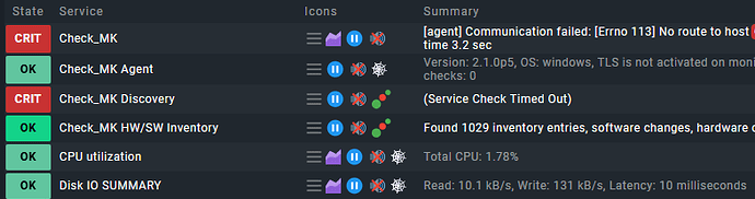

On my 2.1 I see it on the other services when Check_MK service has issues: like timeouts or no response at all due to host being down.
Screenshot from an endpoint that is (in) down(time) and has disabled notifications.
when i run the below command to debug, i can see its taking more time as compare to other servers.
cmk --debug -vvn TEST-SQL-xyxy
Checkmk version 2.2.0p9
  • FETCHING DATA
    Source: SourceInfo(hostname=‘TEST-SQL-xyxy’, ipaddress=‘xxx.x.xx.xx’, ident=‘agent’, fetcher_type=<FetcherType.TCP: 8>, source_type=<SourceType.HOST: 1>)
    [cpu_tracking] Start [7f98fb2d5f90]
    Read from cache: AgentFileCache(TEST-SQL-xyxy, path_template=/omd/sites/watchsite/tmp/check_mk/cache/{hostname}, max_age=MaxAge(checking=0, discovery=120, inventory=120), simulation=False, use_only_cache=False, file_cache_mode=6)
    Not using cache (Too old. Age is 259 sec, allowed is 0 sec)
    Connecting via TCP to xxx.x.xx.xx:6556 (5.0s timeout)
[agent] Success, [piggyback] Success (but no data found for this host),
execution time 167.7 sec | execution_time=167.730 user_time=0.020 system_time=0.010 children_user_time=0.000 children_system_time=0.000 cmk_time_agent=167.700
is there anything step i missed , which we need to follow , while upgrading check-mk agent from 1.6 to 2.2?
