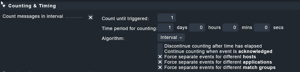

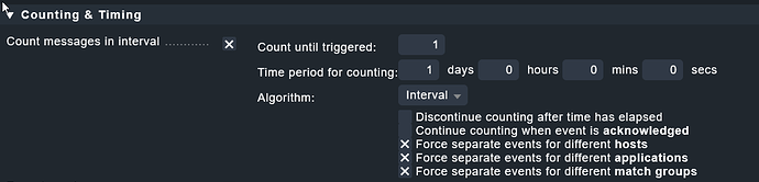

b) Instead of creating notifications directly by mail, use the notification method "forward notification to event console. In the EC you can merge open events for an interval of ie. 24 hours, then you create monitoring notification from the EC events
you might have to limit the event lifetime to 24h as well, so that the event is archived and a new event is created after 24hours
I think b) is way more transparent to other admins/users, but it still feels weird. Maybe someone has a better idea?
