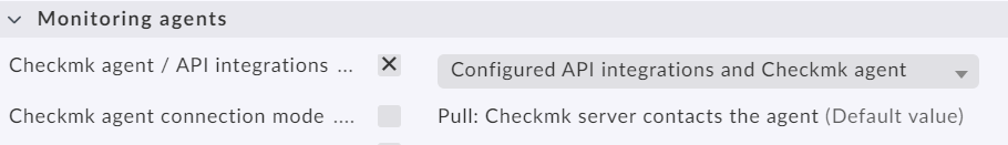

This output comes not from the “normal” agent but from the Proxmox special agent.
It looks like your Proxmox host is only configured to communicate with the special agent.
Can you pls check the host configuration of this host.
It should be configured this way
Then it will use the Proxmox special agent and the normal CheckMK agent.
But i would also inspect why your special agent is not working.
You can get the command line of the special agent with “cmk -D proxmoxhost”
Thank you, I didn’t reinstall the linux agent when I recreated the LXC, and I had the host CMK agent / API integration set to default. The interesting question for me is also, why isn’t the special agent receiving anything by itself? I have the cmkadmin user set with user permissions on the proxmox host correctly, and the special agent rule set up as well.
I don’t think the first time I installed this that I had to install the agent on my proxmox hosts, and the CMK video doesn’t cover installing the agent either. I am receiving data through the agent at this point though, so thank you again.
