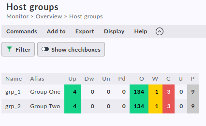

If you put your hosts in host groups, then that membership is automatically reflected in the environment variable NOTIFY_HOSTGROUPNAMES. You don’t need to do anything for that.
For example, I put a host into the two groups grp_1 and grp_2:
… and the notification script is then automatically called with the following variable:
NOTIFY_HOSTGROUPNAMES=grp_2,grp_1

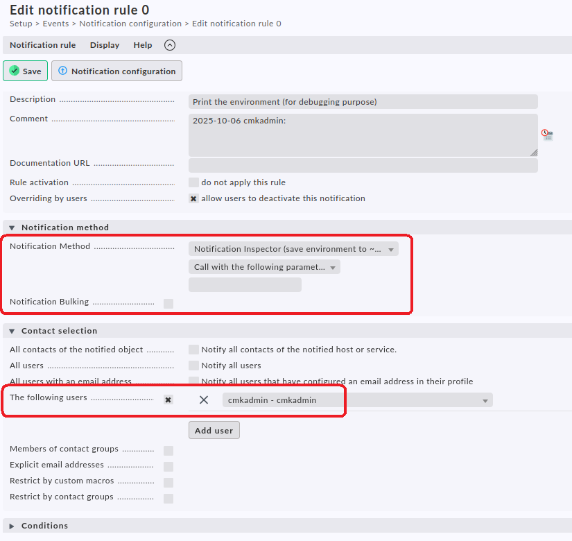

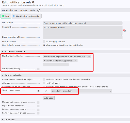

As to why your script doesn’t get called is hard to tell without knowing how you configured the notification process.
Again, I would suggest you first try the environment printer script from above and configure a notification rule for one specific contact and without further conditions:
Then fake the result of any of your services or hosts via “fake check result” and check the file $OMD_ROOT/tmp/notify-env.out.
