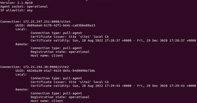

Here this is an example output from an agent controller that is registered to two sites at the same time.
Thx for that Andreas, I didn’t believe you could have multiple connections, but seems you can. Yes its a bit difficult to wrap your head around the fact that the root-ca is pushed to the agent so that the server(s) can initiate a connection. Haven’t had time to test any push/pull TLS/HTTPS stuff
