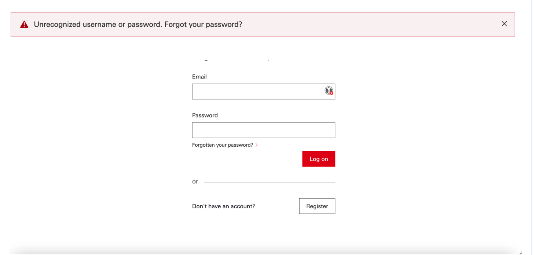

@andreas-doehler Thanks for the reply. I am attaching the screenshot for your reference.
I use devops@mydomain.com:test@1234 to log in to https://develop.mydomain.com/user/login. It works without issue. If I use the wrong password it will report an Unrecognized username or password. Forgot your password? I am attaching the screenshot for your reference.
./check_http -vvv -a "devops@mydomain.com:test@1234" --ssl -u /user/login -H develop.mydomain.com
HTTP OK: HTTP/1.1 200 OK - 334002 bytes in 0.088 second response time |time=0.087709s;;;0.000000;10.000000 size=334002B;;;0
./check_http -vvv -a "devops@mydomain.com:**t1234**" --ssl -u /user/login -H develop.mydomain.com
HTTP OK: HTTP/1.1 200 OK - 334034 bytes in 0.089 second response time |time=0.088863s;;;0.000000;10.000000 size=334034B;;;0
When I use the wrong password I still get 200 OK instead of 401 Unauthorized.
