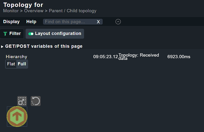

The default topology map showind parent/child is empty. This is after I tried setting yes to the NagVis perssions in the admin role. I reversed the changes (going back to default) but the topology map is now empty.
How do I reverse and get the map working again?

Screenshot attached - it does not show much as the map is empty - that is the problem.
Yes, parents are configured.
-Arvid

But can your user view all the hosts in the other views? Does it have the right permissions for that? :slight_smile:
What looks weird to me is that your headline is different to mine. Yours called Topology for
but mine for example is called Topology for Parent / Child. This looks broken to me. :thinking:

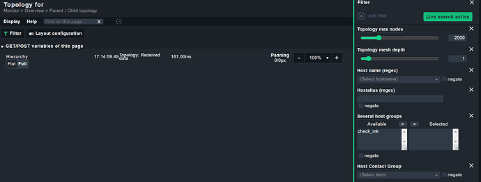

Can you try this URL with your parameters (DOMAIN.TLD and sitename) and see if it’s the same behavior? https://DOMAIN.TLD/sitename/check_mk/parent_child_topology.py

Screenshot http://checkmk.is.compose.se/compose2/check_mk/parent_child_topology.py attached.
-Arvid
Found a solution: Delete the layout. This fixes the problem with the filter not working.
Why? How? No idea.
