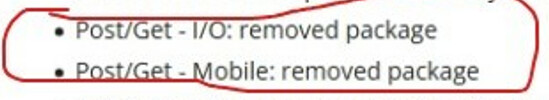

Since Version TRB1_R_00.07.14 (2025.04.24) https://wiki.teltonika-networks.com/view/TRB140_Firmware_Downloads#Changelog of the Teltonika TRB140 the POST/GET package is removed.
So the communication does not work anymore with checkmk :cry:
