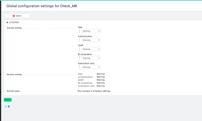

Do you have changed any log settings in the global settings?
Could you reset log related settings to Default?
Hi @aeckstein , no logs setting was done. Is the setting usually done here as shown in the Ui below?
Shall I set all of them to Debug, or only the Automation Calls?
Hi @aeckstein , hope you had a good weekend !! Just wanted to check if the screenshot I provided where I can change the log setting? Sorry, I am kind of new here on CheckMK.
Changed log settings for all them to Debug, hit save. But still need to hit “Activate Affected” or “Activated Selected” to get these working. So, back to the main issue. Anyone can assist?
