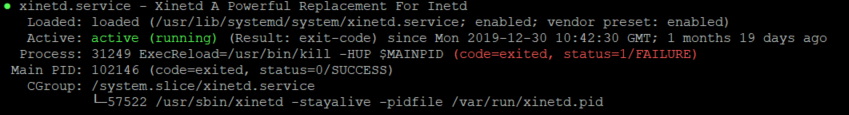

There is a file /etc/xinetd.d/check_mk and the file specifies port 6556. However, when I run “systemctl reload xinetd.service”, I receive the error
“Job for xinetd.service failed because the control process exited with error code. See “systemctl status xinetd.service” and “journalctl -xe” for details.”
If I run “systemctl status xinetd.service” I receive the following::
Do you have any more application or system related files there ? apart from the default ones ?

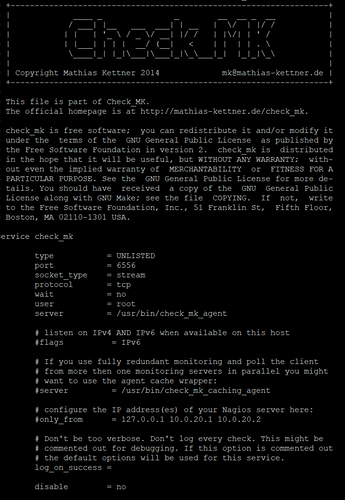

Try to telnet localhost/ip 6556, this should emulate what cmk server does, although you have to allow localhost/127.0.0.1 in check_mk xinetd file if it isn’t present.

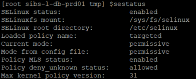

and about selinux ? is it enabled ?
I cannot telnet, it looks like the check_mk file is allowing access from any IP, would this include localhost?
Looks like selinux is enabled:

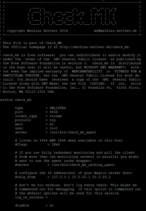

Btw a default check_mk xinetd file would look like this:

yes it is default. My guess would be that you might have another file there that is breaking it.
