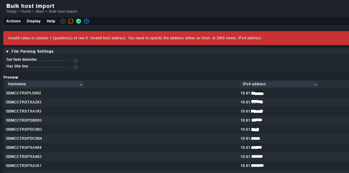

I am trying to import several host using the bulk import feature. It has worked many times before. I am running the RAW version 2.1.0p 22 on Ubuntu 22.04. I have tried several different CSV files. I have even pasted 10 hosts and IP and tried it and still get the following error:
Invalid value in column 1 (ipaddress) of row 0: Invalid host address. You need to specify the address either as Host- or DNS name, IPv4 address.
Maybe if you can show us the data we could see where the issue is.
That is it. Like I said it has worked before. Not sure why it stopped or why I am getting the error.
Here is a screenshot from Checkmk:

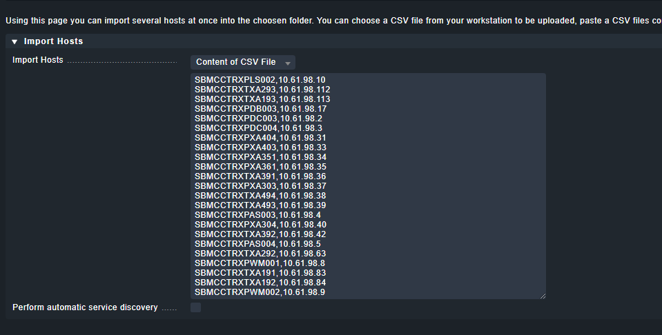

I was able to upgrade to the last version 2.1.0p37.
Here is the data that I tried to simple past and still get the same error. I am not sure what code block is.
