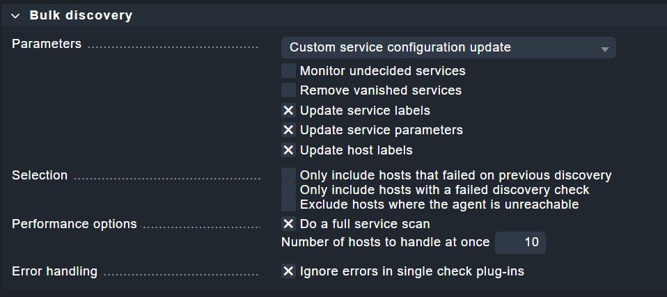

I used Bulk discovery in Checkmk 2.4.0p15 with Custom service configuration and thousands of services got removed:
There were no vanished services reported by the Check_MK Discovery service before executing the bulk discovery.
I tried reverting these changes, but the discovery still removed all services from a large number of hosts:
Hosts: 274 total (226 succeeded, 44 skipped, 4 failed)
Host labels: 640 total (6 added)
Services: 1125 total (0 added, 7535 removed, 1125 kept)
Bulk discovery successful
I don’t think this is supposed to happen, is it?

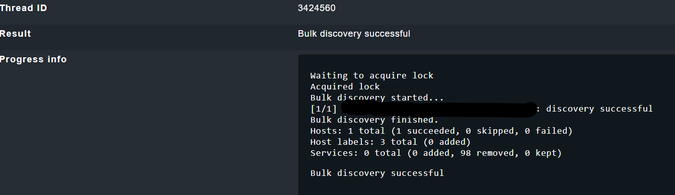

Bulk Discovery, for testing only with one host:
Services are not vanished and should not be removed - but all services of the Host are removed:

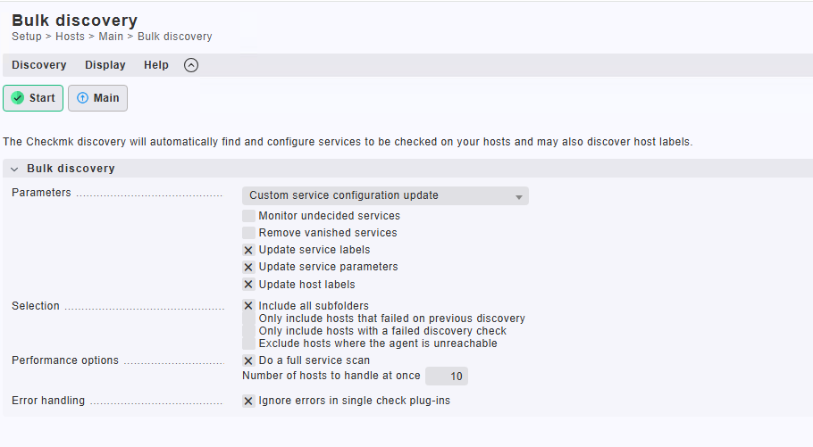

Hi everyone,
this problem occurred only when both options to update service labels and parameters were checked.
The fix will be rolled out with the next patch release: Werk #18348: Removed services during bulk discovery
Have a nice day, Andi
The speeling inside the werk got a little bit wrong :wink:
When both options "Update service parameters" and "Update service parameters" were selected for a bulk discovery, all services were removed from all selected hosts.
