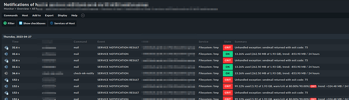

Unhandled exception: sendmail returned with exit code: 75
Hello
I set notification mail for checkmk
in console , using this command
echo "Test de message" | mail -s "Essai Postfix" XXXXXX , i can receive the mail, and checkmk can send mail
but in some case, checkmk is unable to send the notification

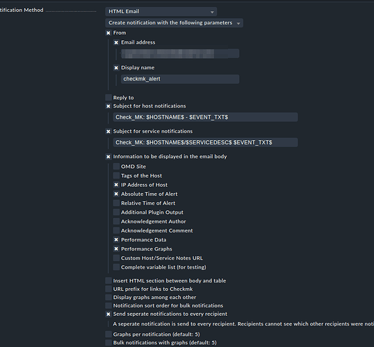

This is my notification rules settings :
in /var/log/maillog , i don’t see errors
Some one have a idea please ?

Ok , i will check my postfix config file, but checkmk is able to send notification for some vm , and for some author vm , isn’t it
