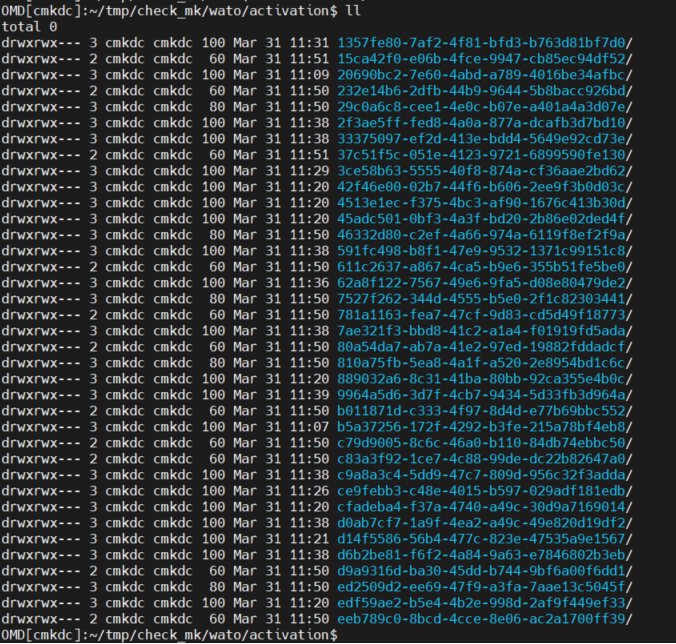

I am experiencing a problem on the master 2.0 post migration it fills up the path /omd/site/cmkdc/tmp/check_mk/Wato/activation/ when I get to this point I get several errors. do you know what the cause is?
error view:
API Error:Cannot write configuration file “/omd/sites/cmkdc/tmp/check_mk/wato/activation/232e14b6-2dfb-44b9-9644-5b8bacc926bd/info.mk”: [Errno 28] No space left on device
thx.
Dario.
Your disk is full, mate. :wink:
It looks like a problem with activating your sites. Remove the folders and try an activation on your sites.
If there is a folder left again you should have also some error messages in the log files.
To be more precise: the site’s tmpfs on ~/tmp
disabling/enabling the site should unmount/mount the tmpfs thus clearing it.
But perhaps first have a look what’s filling it up.
@SAMDAR
I had the same issue with the changes filling up the tmp partition in version 2.0.0p21
See this werk for more information
After I updated to p22, the issue almost never occurs anymore.
Additionally I added a monitoring check for my master server to notify me when it occurs again.
I used this plugin to monitor the directory and configured it to warn/crit at 1GB/1.5GB.
Directory to monitor: /opt/omd/sites/SITENAME/tmp/check_mk/wato/activation/
