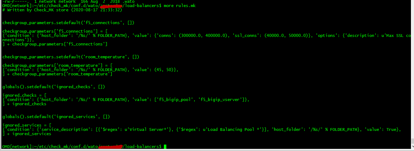

ok went to into into wato into a directory and picked a device I see a host and rules .mk I did a screenshot on rules.mk is this what I am looking for?

The screenshot looks ok.

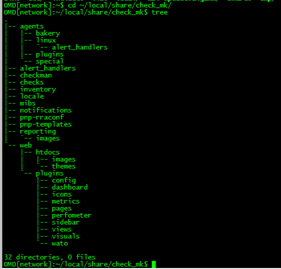

ok I did snapshot restore and removed all deprecated rule sets and package extension and re-did the upgrade still show same error when I start omd also adding below a view of ~/local/share/check_mk/
I removed all packages
