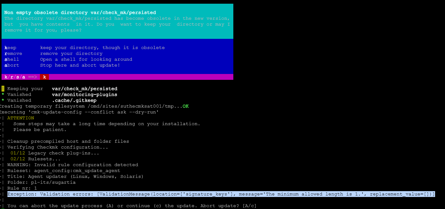

Error output:
Executing ‘cmk-update-config --conflict abort --dry-run’
Update aborted with:
Ruleset: agent_config:cmk_update_agent
Title: Agent updater (Linux, Windows, Solaris)
Folder: main
Rule nr: 1
Exception: Validation errors: [ValidationMessage(location=[‘signature_keys’], message=‘The minimum allowed length is 1.’, replacement_value=[])]
The update is then aborted and rolled back successfully.

Current observation:
Even after removing/recreating the Agent updater, the 2.5.0 update validation still fails on the remote site with:

Full Error message:
Error during update:
Cannot execute omd command omd -V 2.5.0.ultimatemt update --pre-flight=abort --skeleton=install --confirm-version --confirm-edition SITE_NAME: Cleaning up tmp directory...OK

Executing 'cmk-update-config --conflict abort --dry-run'
-| ATTENTION
-|   Some steps may take a long time depending on your installation.
-|   Please be patient.
-| Cleanup precompiled host and folder files
-| Verifying Checkmk configuration...
-|  01/12 Legacy check plug-ins...
-|  02/12 Rulesets...
-| WARNING: Invalid rule configuration detected
-| Ruleset: agent_config:cmk_update_agent
-| Title: Agent updater (Linux, Windows, Solaris)
-| Folder: main
-| Rule nr: 1
-| Exception: Validation errors: [ValidationMessage(location=['signature_keys'], message='The minimum allowed length is 1.', replacement_value=[])]
-| Update aborted with Error: failed ruleset validation.
-| The update can be retried after the error has been fixed.
The update was rolled back successfully.
