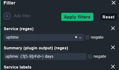

However i want to configure the maximum allowed uptime to tell me when a server has an uptime of say 35 days or more to indicate it hasn’t been rebooted. however i do not want the maximum allowed uptime to send notifications i just want to build a dashboard from the information.

alternative complicated answer:
you could build a service view where you only filter for the output of the uptime check
regex for copy paste: uptime: (3[5-9]|4\d+) days
this way, the services stay in OK, but you can actively check if you have the time
that seems the answer i was looking for thanks! not sure how i didn’t think of that! i only have notifications to critical - so thank you!
