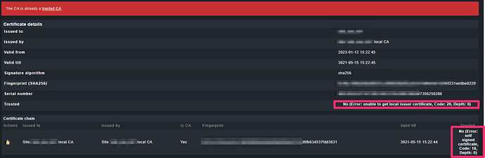

What is the issue here? every time I try to issue a local certificate at first it gets added and it says “trusted” but as soon as I activate the changes I get the following error when checking the certificate again:
Already asked for the CA certificate of their companies and added on the master appliance under

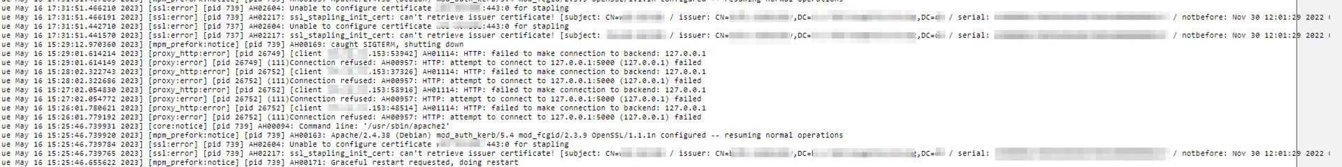

Look into the logs
All the messages looking like a problem with the local Apache SSL configuration.
You are sure that the used certificates and the corresponding CA certificates are referenced correctly from your Apache setup?

I think you have two different problems as the first post problem has nothing to do with the problems from the other posts.
First post looks like a problem with the site internal certificates. All the other posts is a problem with the system Apache certificates.
I don’t know what you mean here with “every time I try to issue a local certificate”. Inside the CMK site you normally cannot issue any certificates manually.

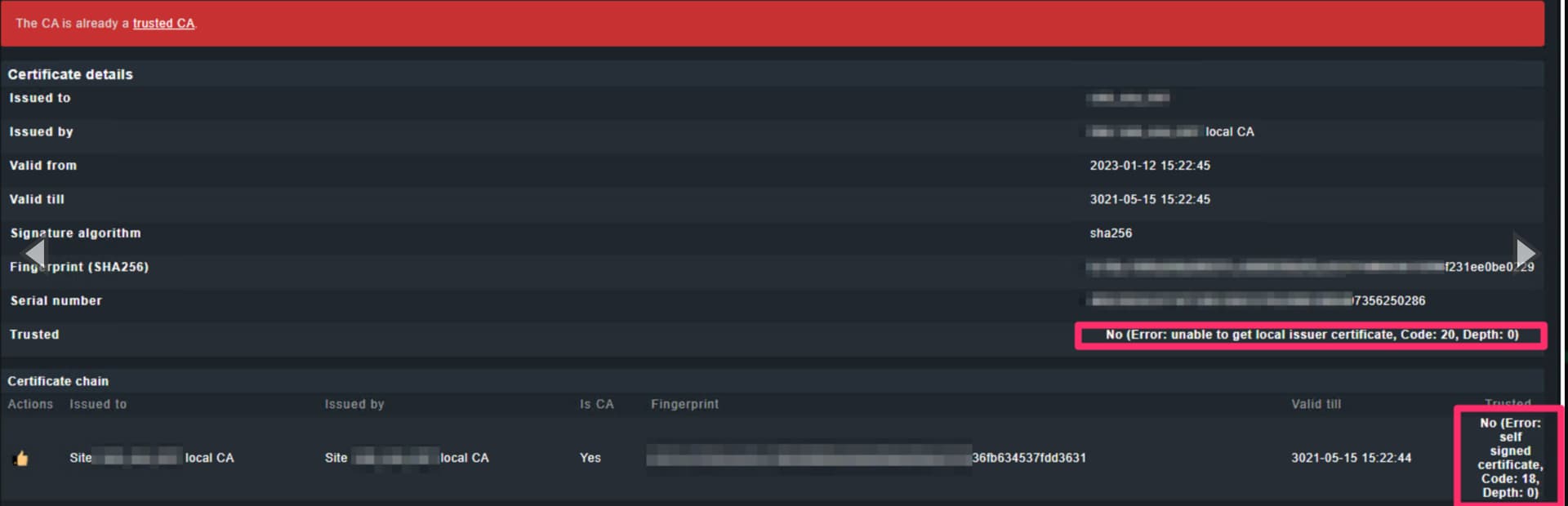

Maybe I expressed my self incorrectly.
I meant the certificate that you normally have to click on the shield icon and add to the certificate trust authorities
But for what you’re saying is a different problem and probably not the main issue here as I have my own certificate.

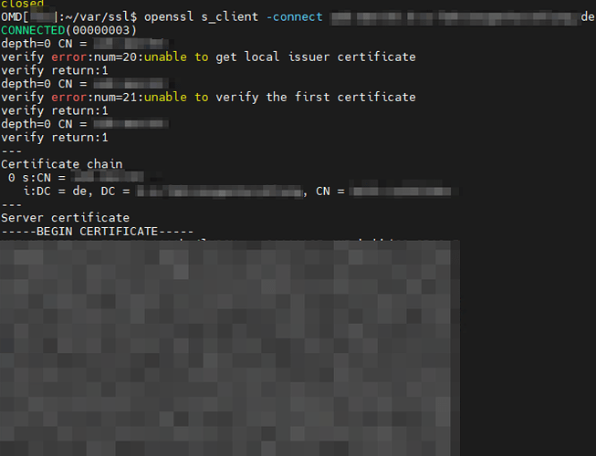

C:\Program Files (x86)\checkmk\service>check_mk_agent.exe updater register -H hostname -U cmkupdate -S password
C:\ProgramData\checkmk\agent\modules\python-3\.venv\lib\site-packages\OpenSSL\_util.py:6: UserWarning:
You are using cryptography on a 32-bit Python on a 64-bit Windows Operating System.
Cryptography will be significantly faster if you switch to using a 64-bit Python.
from cryptography.hazmat.bindings.openssl.binding import Binding
HTTPSConnectionPool(host='site.de', port=443): Max retries exceeded with url: /site/check_mk/register_agent.py
(Caused by SSLError(SSLCertVerificationError(1, '[SSL: CERTIFICATE_VERIFY_FAILED]
certificate verify failed: unable to get local issuer certificate (_ssl.c:1129)')))
Please pay attention you mix here two different certificates.
The screenshot with the CA error is from the livestatus TLS connection and the error from the last post is from the certificate of your system Apache.
These two are different certificates.
