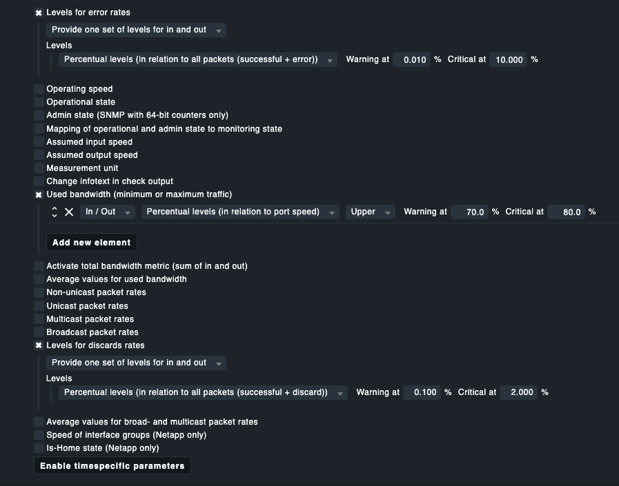

Used Bandwidth rule potential bug
CMK version : 16
*OS version : Ubuntu 22.04.3
** Speed: 200 GBit/s, In: 72.5 GB/s (warn/crit at 17.5 GB/s/20.0 GB/s) (289.84%)CRIT , Out: 9.99 GB/s (39.96%)**
cmk --debug -vvn QFX5120-JAX2.txt (606.4 KB)
Attached output from command. Attached screenshot of rule set applied to this interface
Seeing the check report in both GB and Gbit, not sure if this is a bug. It is causing some false alarms in our monitoring. Has anyone come across this before?

For this problem one important question is the following one.
Is in your system a rule defined for “Fetch intervals for SNMP sections”, if yes please disable this rules and check again if the shown values are correct.
The fetch interval should only be defined for non rate checks that only say a status.
If you define such a rule for rate checks than you need to define a greater check interval for your check_mk service on these hosts.
We do not have this rule defined/applied in any way
