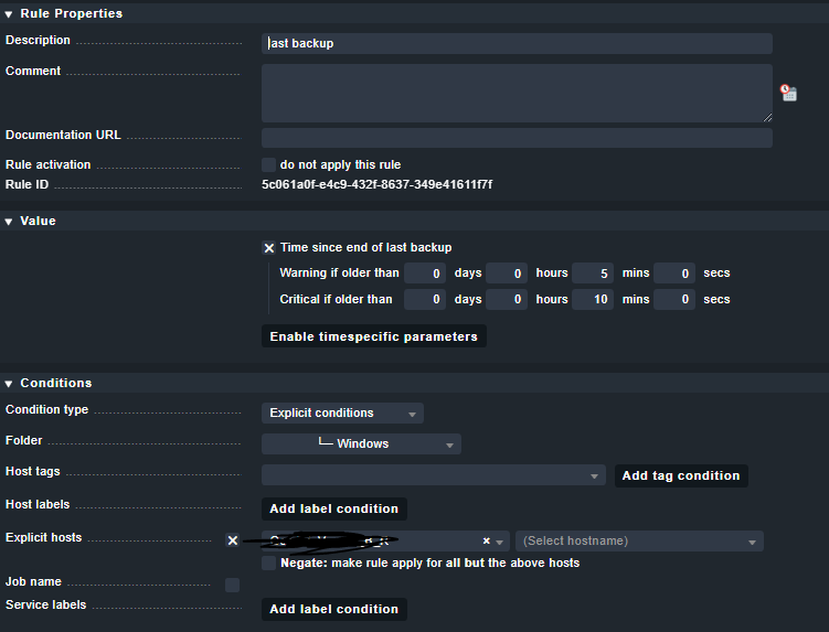

I have the same exact problem as mentioned here, the rule is applied to the VBR mgmt server hosts but the discovered veeam jobs don’t change to WARN/CRIT according to setup thresholds under the rule " [Veeam: Time since last Backup]"
Please assist we have the Enterprise version we just recently upgraded to v2.3.0

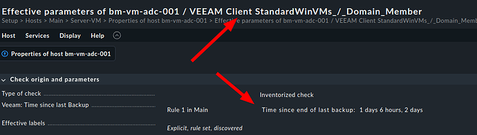

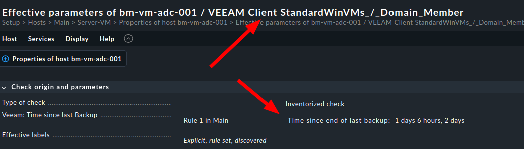

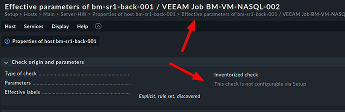

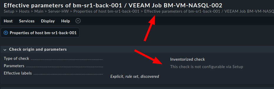

Hello!
We analysed the situation — there is no bug here.
The confusion happened due to the fact that the rule “Veeam: Time since last Backup” is only applied by design to the Veeam Client (the rule’s name is imprecise). It can be applied to the Veeam Client and works correctly:
The Veeam Job cannot be configured with this rule, as you can see in the parameter of the service:
So, the rule works as designed, although the name could benefit from an additional mention of the Client.
On the other hand, adding a rule for the Job would be a request for extending the feature. Please consider adding the idea to our Ideas Portal so it can reach our product team.
