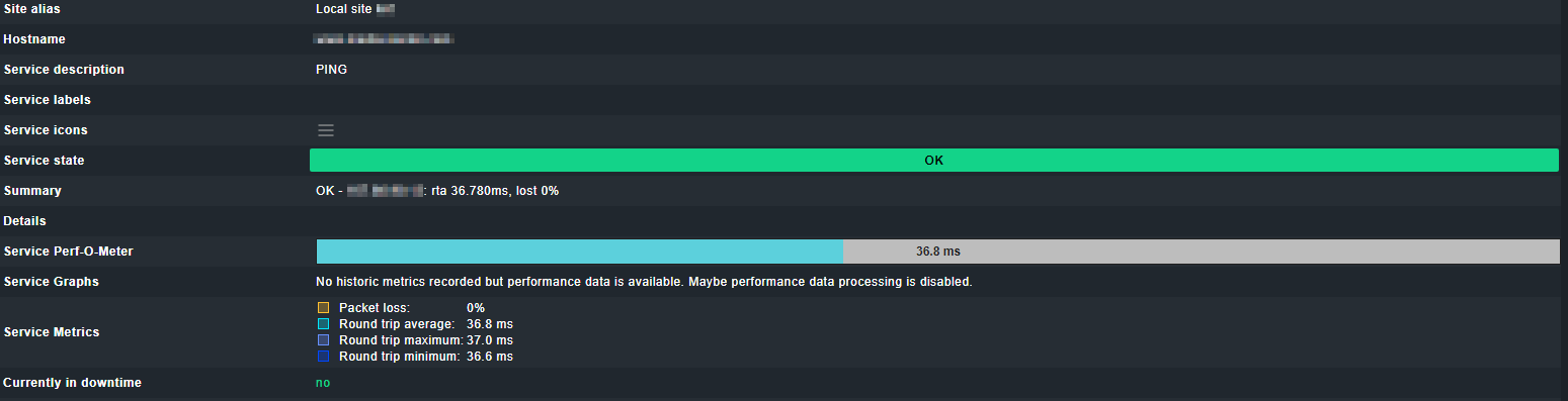

Next strange issue regarding Service Graph of PING-Service. With version 1.6 I had nice graphs, in version 2.0.0p3 graphs disappeared with notice: “No historic metrics recorded but performance data is available. Maybe performance data processing is disabled.”

One other thing - processing of performance data is switched on in your site?
Yes performance data is enabled:
or is there any other place where I can control this?
