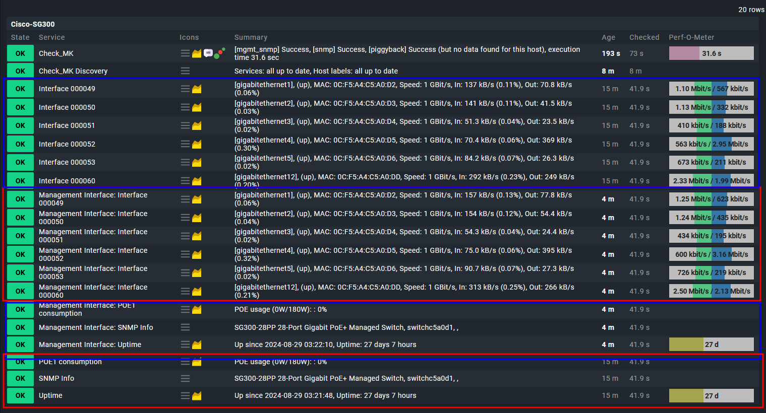

However I’m only getting quite limited and also the data twice:
I have a Cisco SG300 Switch, I have the custom MiB package (not sure if there is a way to import) and a smpwalk works fine and gives around 250k lines back.
Any ideas how I can get checkmk to give me more stats, for example CPU, disk, ram, FAN, temps, connected devices, more interface data like interfaces with DOWN status.

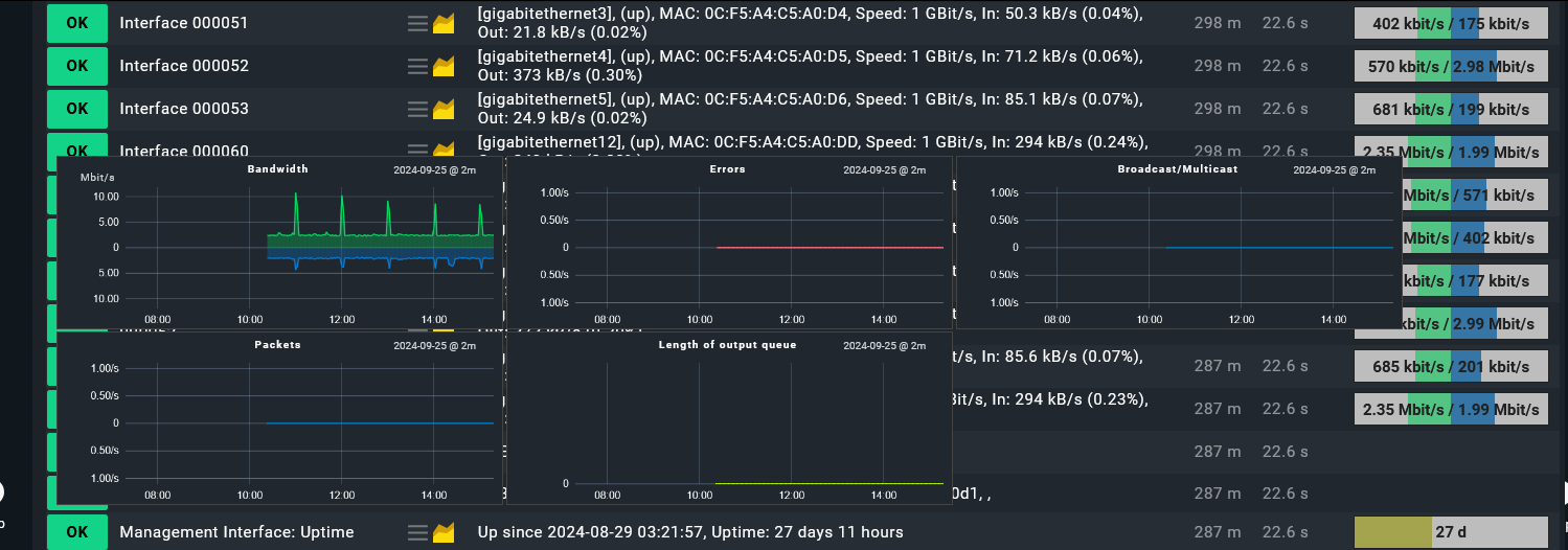

Yes there are more infos on the grahps icon:
However still many things are missing, like CPU, RAM, Disk, status of other Interfaces, Firmware version, FAN status, temps, …
Thanks for any tips on how to get those metrics!

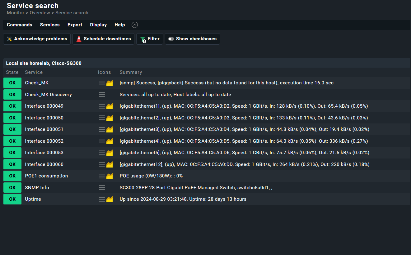

Regarding your duplicate entries: You probably have entered the ip address in the host configuration twice. Once under the network address section and once below Management board. Please remove the second one.

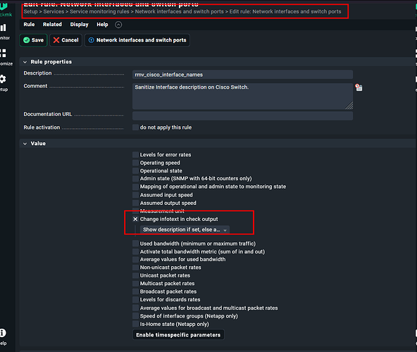

    By the way: You can use the rule “Network interface and switch port discovery” to switch the interface names to “use description”. So you get rid of the numbered interface names.

I just tested the suggestion with switch interface name, however I’m not sure if I’m doing it correctly, here is what I configured:
Here is what I can view after applying, to me it seems like it did not change at all.

Check out this blog for the use of description or alias as service name for interfaces:

Thanks @Yggy that worked wonders :slight_smile:
