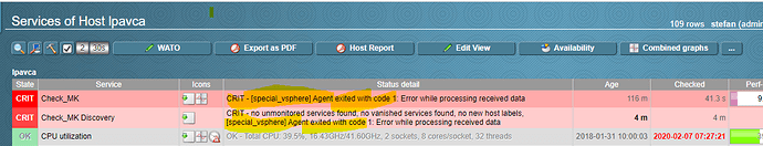

sorry but problem is not solved.
I have changed userid but i get always “old userid” in vmware message ! I can’t find any other entry im check_mk.
Message in vsphere is, that wrong userid from check_mk host tries to logon !

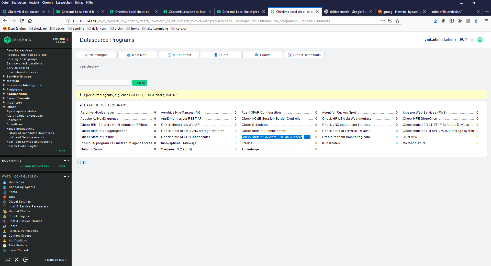

Hosts – Rulesets – Datasource Programs
the marked Option Number should be greater than 0
here you shouls find rules and used logins
Ralf

yes, there is the correct userid defined ! How can i check if another service tries to logon with wrong userid ?

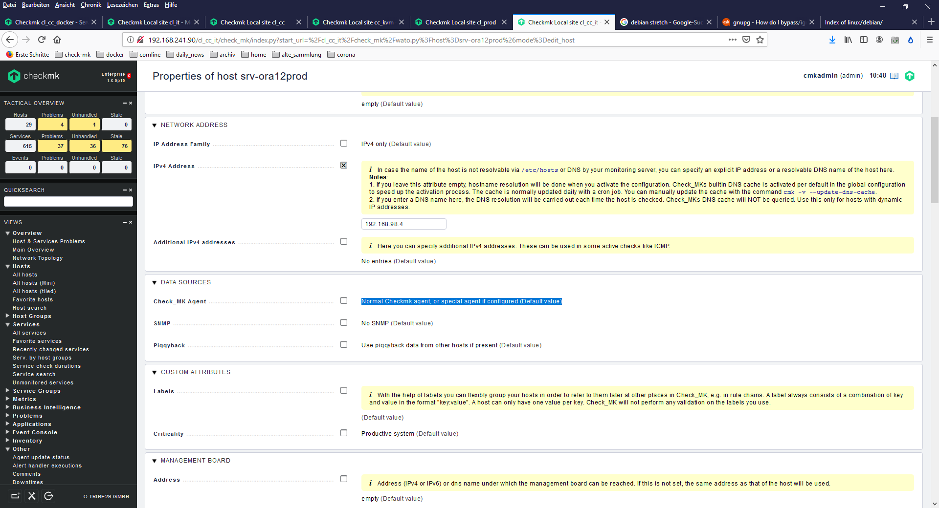

check the type of the agent configured for your host
Ralf

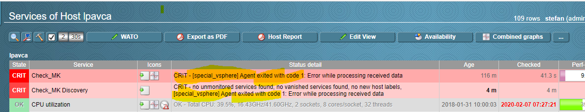

i found some strange things.

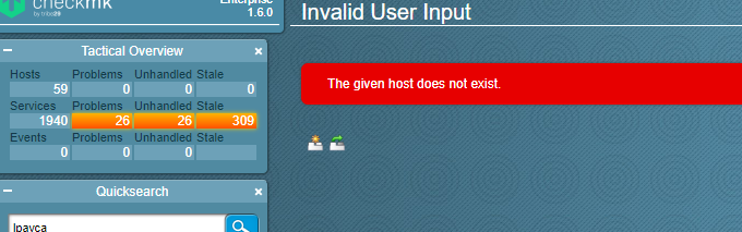

  1. this host was not correctly definied, therefore it was unable to get properties from this host.
  2. I have added this host to system - always still error messages
  3. i made a restart of check_mk - correct new defined userid from VC makes a sucessfull login !
I hope this will work in the future
Stefan
