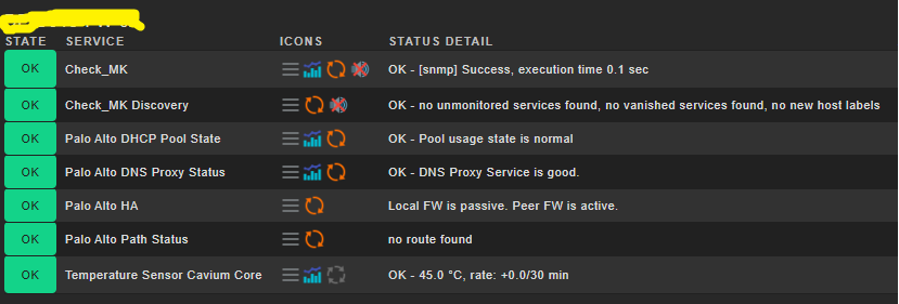

We have a bunch of Palo Alto Firewalls (>500) which are replaced by newer models where we exactly face this problem:
SNMP Discovery would not discover >>all<< new/vanished services (in our case new interfaces are not added but a new temperature sensor is) and until we trigger the SNMP query (i.e. “Check_MK”) and the discovery (i.e. “Check_MK Discovery”) once one after another by hand in the webinterface.

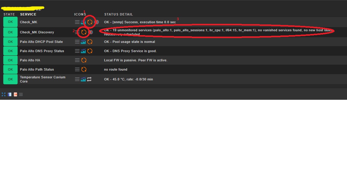

Hi Andreas
i just tried it one more: Check_MK and Check_MK Discovery running as scheduled, both green but no services discovered. Triggered Check_MK (1) and then Discovery right afterwards (2) t and voila: Service Discovery recognizes new interfaces’n’stuff. (3)
I see that it might not be related to Werk 10534 So why would it not work by itself?

I edited my last post with a screenshot to show the steps i take

Hi Andreas
we have set this:
Service discovery check for SNMP devices:
Perform full SNMP scan always, detect new check types
And still: the firewalls showed up as attached screenshot, until the discovery was triggered either via CLI or when trigering the agent and then discovery afterwards (see screenshot above)
