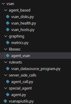

for 2.3 new plugin development should be located in
~/local/lib/python3/cmk_addons/plugins/<plugin_name>
Here you separate your files accordingly :
…/<plugin_name>/agent_based/
…/<plugin_name>/checkman/
…/<plugin_name>/rulesets/
…/<plugin_name>/server_side_calls/
…/<plugin_name>/special_agents/
…/<plugin_name>/libexec/
…/<plugin_name>/(…)
You have a good plugin to check as template on exchange - maybe it helps you going further on developing :
https://exchange.checkmk.com/p/workshop-conf10
Hope it points you in the right direction.

The base is “~/local/lib/python3/cmk_addons/plugins/”. The folder of the plugin is “vsan” here.
grafik
The concept is:

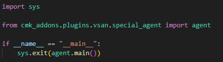

  1. The script “server_side_calls/agent_call.py” is responsible to generate the commandline :
    (which you can see when you excute “cmk -vvv --debug HOST”)
  2. which calls the wrapper ~/local/lib/python3/cmk_addons/plugins/vsan/libexec/agent_vsan
    grafik
  3. which executes the main() method in “special_agent/agent.py”
In my case main() executes pyvmomi calls which output checkmk agent sections.
