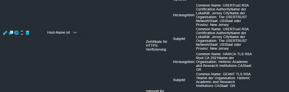

ich habe nun versucht die Lösung nachzubauen indem ich für beite zu testende Hosts jeweils einen eigenen Agenten gebacken habe. Leider ohne Erfolg, obwohl es eigentlich so passen sollte. Könnte in die Problematik noch irgend eine andere Konfigurationsstelle rein spielen?

Neues Zertifikat ==> Updater ERROR
openssl s_client -connect CMK-SERVER:443 -showcerts | egrep ‘s:|i:’
depth=2 C = GR, O = Hellenic Academic and Research Institutions CA, CN = HARICA TLS RSA Root CA 2021
verify return:1
depth=1 C = GR, O = Hellenic Academic and Research Institutions CA, CN = GEANT TLS RSA 1
verify return:1
depth=0 C = DE, ST = Nordrhein-Westfalen, O = OOOOOOOOOOOO OOO, CN = CMK-SERVER
verify return:1
0 s:C = DE, ST = Nordrhein-Westfalen, O = OOOOOOOOOOOO OOO, CN = CMK-SERVER
i:C = GR, O = Hellenic Academic and Research Institutions CA, CN = GEANT TLS RSA 1
1 s:C = GR, O = Hellenic Academic and Research Institutions CA, CN = GEANT TLS RSA 1
i:C = GR, O = Hellenic Academic and Research Institutions CA, CN = HARICA TLS RSA Root CA 2021
2 s:C = GR, O = Hellenic Academic and Research Institutions CA, CN = HARICA TLS RSA Root CA 2021
i:C = GR, L = Athens, O = Hellenic Academic and Research Institutions Cert. Authority, CN = Hellenic Academic and Research Institutions RootCA 2015
$ cmk-update-agent -v
Updated the certificate store “/var/lib/check_mk_agent/cas/all_certs.pem” with 3 certificate(s)
| Checkmk Agent Updater v2.3.0-2025.05.26 - Update |
Getting target agent configuration for host ‘kn01p3ap801’ from deployment server
Failed to connect to Agent Bakery: HTTPSConnectionPool(host= CMK-SERVER ', port=443): Max retries exceeded with url: /SITE-MASTER/check_mk/deploy_agent.py (Caused by SSLError(SSLCertVerificationError(1, ‘[SSL: CERTIFICATE_VERIFY_FAILED] certificate verify failed: unable to get local issuer certificate (_ssl.c:1076)’)))
Retrying with fallback URL: https:// CMK-SERVER-A /SITE/check_mk
HTTPSConnectionPool(host= CMK-SERVER ', port=443): Max retries exceeded with url: /SITE-INSTANZ/check_mk/deploy_agent.py (Caused by SSLError(SSLCertVerificationError(1, ‘[SSL: CERTIFICATE_VERIFY_FAILED] certificate verify failed: unable to get local issuer certificate (_ssl.c:1076)’)))
See syslog or Logfile at /var/lib/check_mk_agent/cmk-update-agent.log for details.
