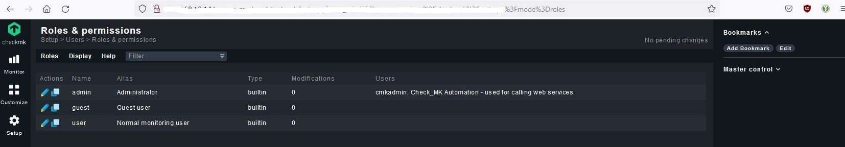

Thank you for your reply.
As you can see from the attached photo, the user “automation” does not exist in the menu list you suggested. Is this normal? Do I have to create it? Is it not created by the installer?
That is the roles page, not the users page.

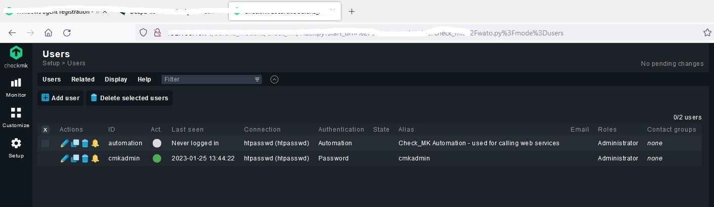

Yes Robin i have noticed it now.
But if there are no permissions referring to the user can the user exist?
Anyway, i attach the screenshot of the users as well.
Thank you again for your interest.
With Administrator role you are as usual on the save side.
