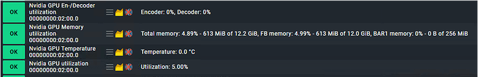

I had to change nvidia-smi path, on our environment is in different location. However after upgrade from Raw to Enterprise I forgot to update agent. :man_facepalming:
After agent update from Enterprise 2.3.0p2 it works now:
