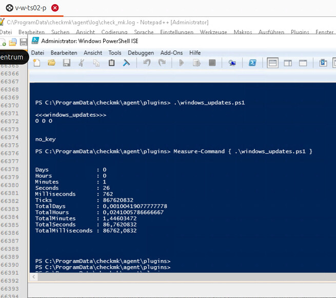

The script is running suprisingly long:
In a admin-cmd window. The dump command via “cmk-agent-ctl.exe” is NOT containing the “<<<windows_updates>>>” section

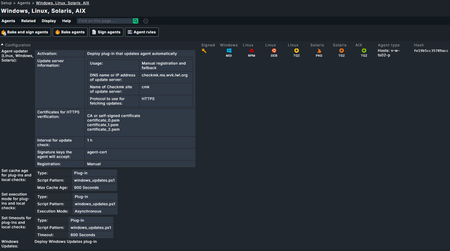

I have tried to enlared the check duration like so, but this is also not working:
What could be the cause of this problem?

Can you check if has really your config with the 600 seconds timeout?
A “check_mk_agent.exe showconfig” can give use the running config.
The log file locks like a 30 second timeout for the plugin not 600 seconds.
