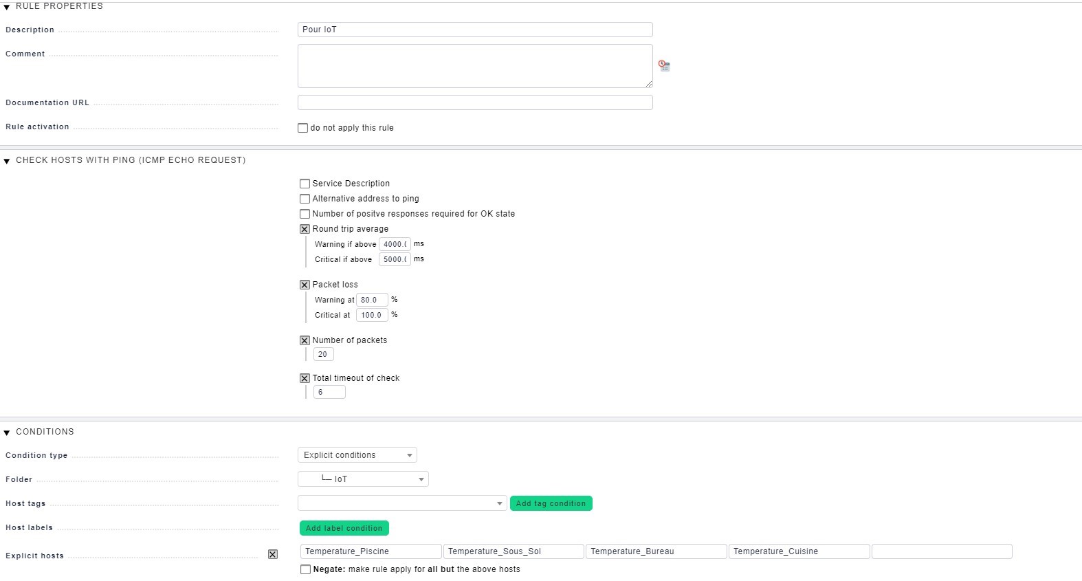

I thought maybe it was the threshold for icmp, so I set a rule in the folder where my device are, 4000 warning and 5000 critical, packet loss 80% warning, crit at 100%, number of packet 20, total of timeout 6.

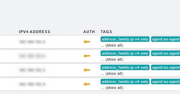

Thanks for your reply. I have double check, they are in the right folder. See image Below
Imgur
Imgur

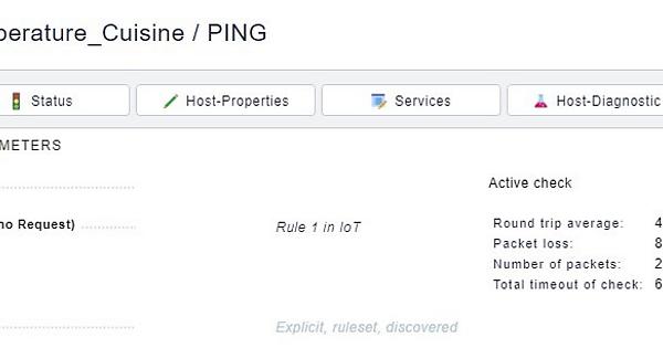

thanks again for your time :slight_smile:
Imgur
Parameter for the host, there no rule need to be trigger, but on the service PING
Imgur
