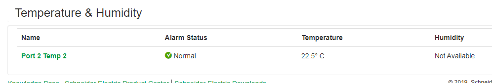

On this card we use the external temperature sensor that reports correctly its data to the webinterface of the APC but it doesn’t report it back to check_mk when using apc_symmetra_ext_temp

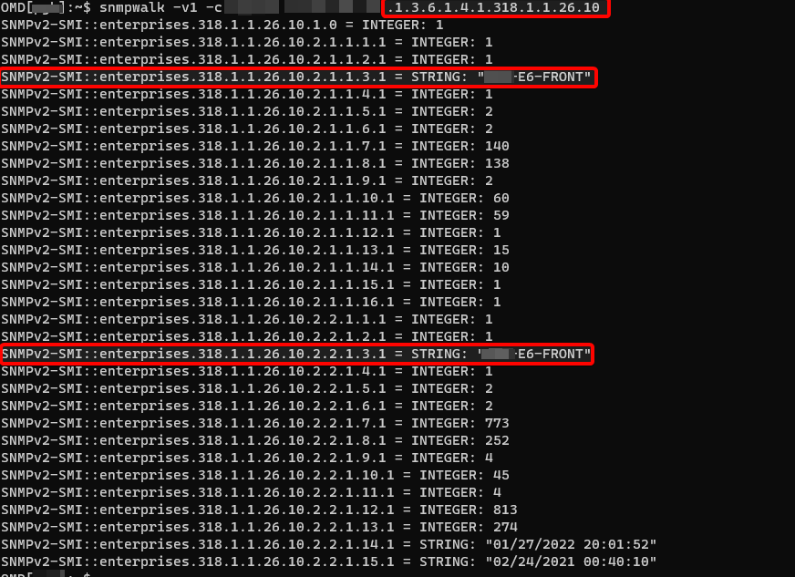

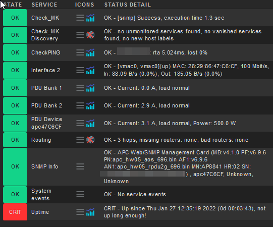

I just bought an external temperature sensor for an CPU PDU hoping CheckMk would see it, but so far, no good. Anyone monitoring temperature off of an APC sensor?
OK, here’s a clue. Looks like the sensor is at SNMP OID .1.3.6.1.4.1.318.1.1.26.10 according to this: https://www.apc.com/us/en/faqs/FA156179/ .

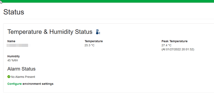

Sure enough, if I snmpwalk that I see my sensor name in there. What do I do with this now though? None of the values look like anything that match the values I see in the APC gui.
I see the apc_symmetra_ext_temp check is compiled python so I can’t experiment with making changes to my own local version.
