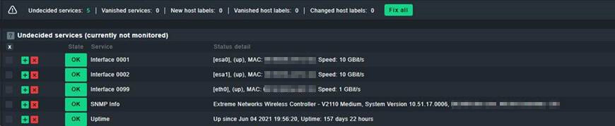

Access Points not showing when monitoring the Wireless Controller
Since these Access Points (they’re extreme) don’t support direct SNMP Access, we though about using the WLC.
Those are the configurations we used. By enabling the “publish AP as interface of controller” it would be expected to show on CheckMK the Access Points as interfaces of the controller, which is not the case shown in the image below.
We tried on the others controller’s as well, same result.
Also, when we do a snmpwalk over the ifmib table you see all the accesspoints as interfaces, so it doesn’t look like an Extreme Wireless controller problem.
